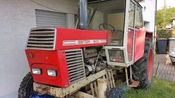

I recently bought a farm here in Sweden, and so naturally I had to buy a tractor. I really didn't need a tractor, but I wanted one, because I had a farm... :) I found a decently cheap 1974 Zetor 8011 and I fell in love. The large hydraulic leak didn't bother me at the time, but a year and 50 liters of oil later we started the repairs.
Me and my father removed the cabin today, and are continuing working on splitting the tractor to fix the leak (and everything else wrong). While my father does most of the work, I try to stay out of the way and even help home sometimes. The whole tractor will get a fresh coat of paint and everything looked over. All the electrics will be replaced.
Attached is the current state of the tractor :)

Willkommen im Forum :welcome
zum Glück ,gibt es Googel Übersetzer
Ich freue mich den wieder zusammen gebaut und mit neuer Farbe zu sehen viel spaß beim Reparieren
Welcome Niklas!
But you still have a lot of work to do. OK, but the workshop also seems well equipped. Would be nice to see more photos of your work on the Zetor. :)
Hehe, there might be some work left... : whoa I'm having real difficulty finding the Zetor 8011 "beige" color of the frame. I think the red parts will look ok in RAL 3002, but I can't seem to find any reasonable color for the beige parts. Or can it really be RAL 9001?: nolike It seems too white to me.
